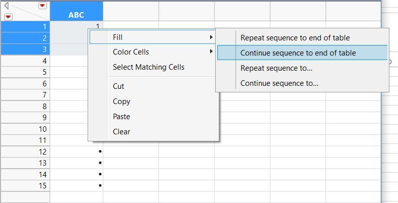

Hi,
I am new to JSL script. Can anyone teach me how to write the script for below option, "Continue sequence to end of table". I would like to automate this process. I only able to find script to key in the first three rows as below:
dt << New Column("Time","Continuous", Set Values([1,2,3]));
Then not sure how to automate it if I want to Continue sequence to end of table.

JMPScreenSnapz293.pngThere are some functions available interactively that don't have JSL equivalents. Most of these are things that only make sense interactively. In this case, it's assumed that as a JSL author you can create the data you want as you want it.
For the pattern you're looking for you should examine the Row(), Count(), and Sequence() functions.

If you just want to fill the column with the sequence 1, 2, ..., you can use this JSL:
dt=Current Data Table();
dt << New Column("ABCD", Numeric, Continuous, Set Values(1::NRows(dt)));
The statement
a::b
,where a and b are integers, creates a vector of sequencial values from a to b, indexed by 1.   More generally, a::b::increment returns [a a+increment a+2*increment ... b].  For example
2::20::2
returns [2 4 6 8 10 12 14 16 18 20]
If you want a script that will contine the sequence based on the selected rows, that would be a little bit more work to create, I think.
