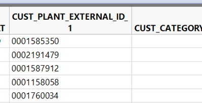

IN JMP I have file that contains a column that looks like this;
When I save it in EXCEL, the leading 0's are trimmed... thus, 0001585350 gets trimmed to 1585350

JMP is exporting all of the leading zeros.  It is Excel that is stripping them off.  Your suggestion of placing a non numeric value in of the column's values would be one way to preserve the leading zeros.

It does appear that Excel is stripping off the leading zeroes.  Guess you'll have to stay in JMP and not use Excel LOL.  But if you must use Excel, you can preface the values with a single quote.  Here are the JMP table and Excel spreadsheet:
