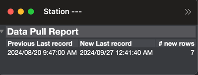

I would like to save a small report generated as New Window () as script into the data table, after concatenation, so I can generate it later from the datable directly.
I am trying the function << get script and << new script but it doesn't work, the generated script fails.

oldlastrecord= format(Col Maximum(dt:stored_at), "y/m/d h:m:s");
Newlastrecord= format(today(), "y/m/d h:m:s");
Ndata = Nrows(dt);
ReportMsg = New Window( "Station ---",
	//<<modal(),
	Outline Box( "Data Pull Report",
		Table Box(
			String Col Box( "Previous Last record", oldlastrecord ),
			String Col Box( "New Last record", newlastrecord ),
			Number Col Box( "# new rows", Ndata )
ReportScript = ReportMsg << get script;
show(ReportScript); // <-- the format of the script (see log) is very different from ReportMsg above
//Attempt at saving the script <--- fail
//Eval( Eval Expr( dt << New Script( "Data Pull Report", Expr( ReportScript )) ));
the log generates the following
