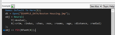

jthi
Re: JSL - Repeats within a platform function
You could move the Fit(NTanH()) outside the Neural(). Below is example from scripting index:
Modified version from scripting index with for loop:
Names Default To Here(1);
dt = Open("$SAMPLE_DATA/Boston Housing.jmp");
obj = Neural(
	Y(:mvalue),
	X(:crim, :indus, :chas, :nox, :rooms, :age, :distance, :radial),
	Set Random Seed(2)
For(i = 1, i <= 2, i++,
	obj << Fit(NTanH(4));
-Jarmo

Joost
Level II
Hi Jarmo, that was an option that I did not try and it is a solution to my problem. Works fine. Thank you!

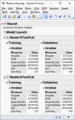

The code isn't finding correct references, it could be that changing rpt = Current Window(); to rpt = Current Report() is enough, but I would strongly suggest using the reference you (can) have (in my example obj)
obj = Neural(
	Y(:mvalue),
	Set Random Seed(2),
	<< Fit(NTanH(4)),
	<< Fit(NTanH(4)),
	<< Fit(NTanH(4))
Report(obj)[Outline Box("Neural")][Outline Box("Training")][Table Box(1)] << Make Combined Data Table;
-Jarmo
