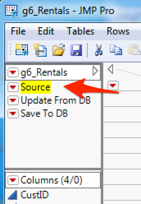

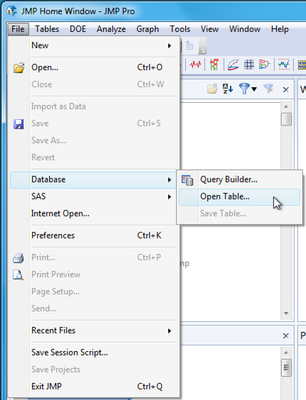

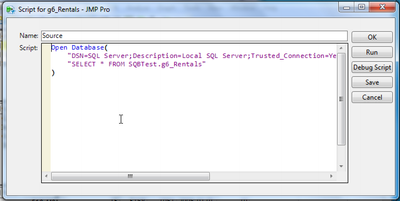

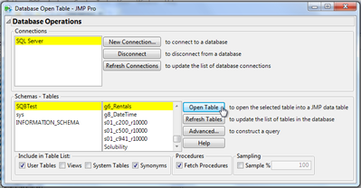

The best way to get the JSL for most anything in JMP is to do it interactively and then get the script from the result.
For dealing with ODBC databases, choose File->Database->Open Table... and work through the dialogs to open the table you're interested in and then look at the Source script in the resulting data table. It will have the JSL to open that table.
