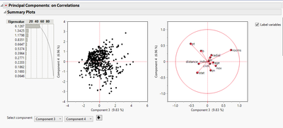

Hi All,
  I'm working on a larger set of JSL code and am interested in adding some functionality to it so that the user can cycle through different views -- something like what one can do when cycling through the different components in the PCA platform, see screen shot below.
  I know that I need a couple Combo Boxes with the relevant columns from the data table, but I'm not sure how to get the graph to auto-update like in the PCA platform or how to correctly call the Next button box. I would also like to add in a Previous button box so the user can step back in the view more easily.
  If anyone has some suggestions or ideas on how to implement this, I'd appreciate the help. I haven't been successful searching for this functionality or finding much about it in the Scripting Index or Scripting Guide that I have.

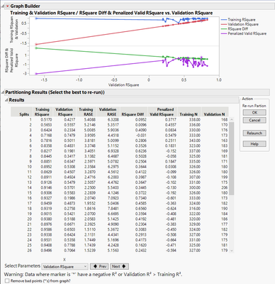

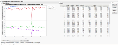

Re: JSL: How to script a graph update with Combo box and Next/Prev buttons
Hi @ian_jmp ,
  I'm hoping you might be able to help with correctly getting this script to work when I have more elements in the new window. I have been able to take my concept script that worked on its own and move it over into a larger script that partitions the data and displays the results. I'm attaching my JSL code as a file, might be easier that way. It opens the Boston Housing and you can select the data table and then X factors and Y Response and set a validation portion and the max number of splits to attempt.
  The code works to generate the output I want (below):
But, when you cycle through the parameters, it rearranges the layout of the window into this:
I'd like to keep the same layout as the first screenshot, but the Prepend and Append options are not maintaining the right layout. Any help is much appreciated.

SDF1
Update: OK, so I needed to do a little more reading in my Scripting Guide about Append, Prepend, Sib Append and Sib Prepend. After reading up on this, it was a matter of determining which container box I needed to prepend the updated graph to. So, when it comes to having other container boxes in a window, you might need to use the Sib Prepend() command. Makes sense now that I see it.
The attached JSL does all that I intended, if anyone is interested.
