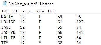

What version of JMP are you using?  I don't replicate the behavior using JMP 14 with the following simple example:
Preferences(
	ExportSettings(
		End Of Line( CRLF ),
		End Of Field( Tab ),
		Export Table Headers( 0 )
dt = Open( "$SAMPLE_DATA\Big Class.jmp" );
dt << Save As( "$TEMP\Big Class_text.mdf", "text" );
Notice there is no double-quote shown at the top of the file in a common text editor:

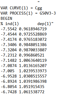

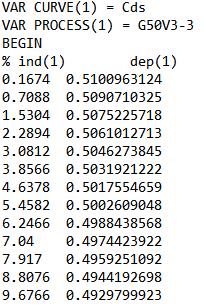

Doing that returns the image shown below, which still includes the quotation marks.image.png
How do I get my output to go from the format shown below:
To this format shown below?
