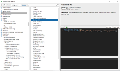

Build your dates (different ways, see date-time functions: JSL Syntax Reference > JSL Functions, Operators, and Messages > Date and Time Functions ), use file path with creation date (note if your folder ends with "/" or not when building the path) and add comparison
Names Default To Here(1);
folder = Convert File Path("$SAMPLE_DATA");
sdate = Date DMY(1,1,2025);
edate = Date DMY(31,3,2026);
flist = Files In Directory(folder, Recursive(1)); filtered_files = Filter Each({filename}, flist, Contains(filename, "Data") & Ends With(filename, ".jmp") & File Size(folder || filename) > 0 & sdate <= Creation Date(folder || filename) <= edate );

Use Creation Date()
Difficult to give any suggestion on what to combine it with as you didn't provide any ideas of the logic you are going for.

Re: JSL: Filtering files by Creation Date with Files In Directory and Filter Each
