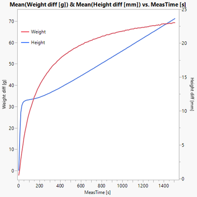

Hello JSL Scripters,
  I'm working on a script, where I am adding my own "legend" to a graph. See screenshot below.
  I've added the lines and text by right clicking in the graph Customize...> and then adding a Script to the graph. The following JSL generates the "legend" as shown above.
Pen Color( "Red" );
Pen Size( 2 );
Line Style( "Solid" );
Line( [20, 100], [65, 65] );
Text( {120, 64}, "Weight" );
Pen Color( "Blue" );
Pen Size( 2 );
Line( [20, 100], [60, 60] );
Text( {120, 59}, "Height" );
  But, what I'm really after is how to make the positions of the legend lines and text relative to, e.g. 90% the maximum value in the column :"Weight diff [g]"n. Data table is attached as well with script (non working script is commented out). I thought I could do it with something like an Eval(Substitute(Expr(...), Expr(__pos__), pos) type of JSL, but I keep getting the "Invalid Matrix Token" error. With something like the following:

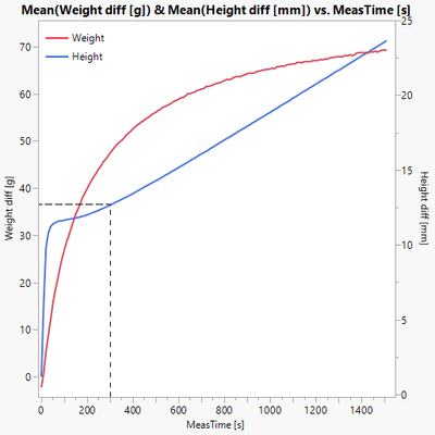

In case other readers are interested, I modified the JSL code (see below) to:

Which makes the following output:
Which are demonstrations of exactly what I was looking to do -- create relative "legends" and specific reference lines that don't go across the entire length/height of the graph.
  Hopefully this can help others looking to do something similar.
