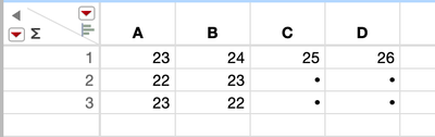

I have the following data table:
I imported this data table into a JSL matrix
Data1 = Data Table( Current Data Table() ) << Get All Columns As Matrix;
This produced the following matrix named Data 1 :
[ 23 24 25 26,
22 23 . .,
23 22 . .]
I requested the number of columns in this matrix:
c = ncol(Data1);
This generated the following error message:
Cannot set value for the column 'C' because the row number (0) is not valid. in access or evaluation of 'Assign' , :c =  /*###*/N Col( Data1 ) /*###*/
I would appreciate any help understanding the error message and/or how to get the number of columns in Data1.

Craige_Hales
Re: JSL Error When Requesting Number of Columns in a Matrix
C is a column in the data table. Pick a different name is the simple answer. You can also use namespaces.
The message
means C is a column, not a simple variable and JMP does not have a way to figure out which row of the data table should receive the new value.
Craige

Craige_Hales
The message
Craige
