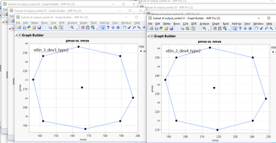

A while back, I got help from here on JMP coding to draw diamond plots (attached snapshot). I am using the same code. For some reason, the code run through without any flag but does not generate the plots. I am using JMP Pro 17.2.0. Can anyone please help me debug this? Much appreciated. I attached the dataset on which I am trying to use the script. Let me know if any additional questions.

What version of JMP did this work in?
try adding a num(...) to convert the "2" to 2 .
:width == num(byGroup3[kk])
I don't know why or if this changed, or what changed. bygroup3 holds {"2", "3"} but column :width holds numbers 1 and 2.
With that change you'll get a lot of graphs, doesn't look quite like your example.

hasanurkhan
Level III
Re: JSL Coding debug help needed
Thank you so much. It worked on my side. in my snippet, I showed multiple diamond plots but that I can do on my side.
