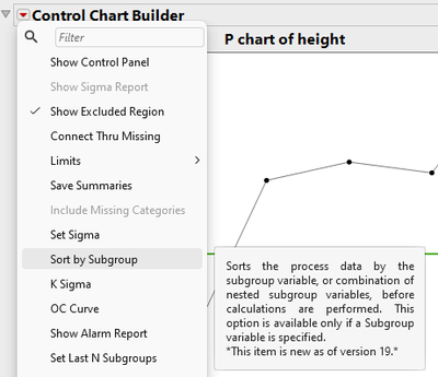

jthi
Re: JMP19 not summarizing Subgroups properly in p-Chart
Most likely this has been answered quite a few times in community (or something very close to it). Quite a few of issues related to control chart builder in JMP19 can be solved by enabling this
Control chart builder JMP 19 - How to group together X axis values
-Jarmo
1 REPLY 1
jthi
