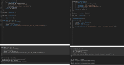

using JMP 19 I found now, that it needs a lot longer doing database queries via ODBC.
See below screenshot,
using one ODBC connection (that includes authentication)
  • JMP19 needs 50 s for the first connection and 25 s for following ones when connection is establisched
  • JMP18 needs 25 s for the first connection and less than 1 s for following queries
When using a more simple ODBC connection (with UID+PWD):
  • JMP19 needs 11 s for first connection and ~ 5 s for following ones
  • JMP18 needs 8 s for first, and ~ 1 s for following ones
