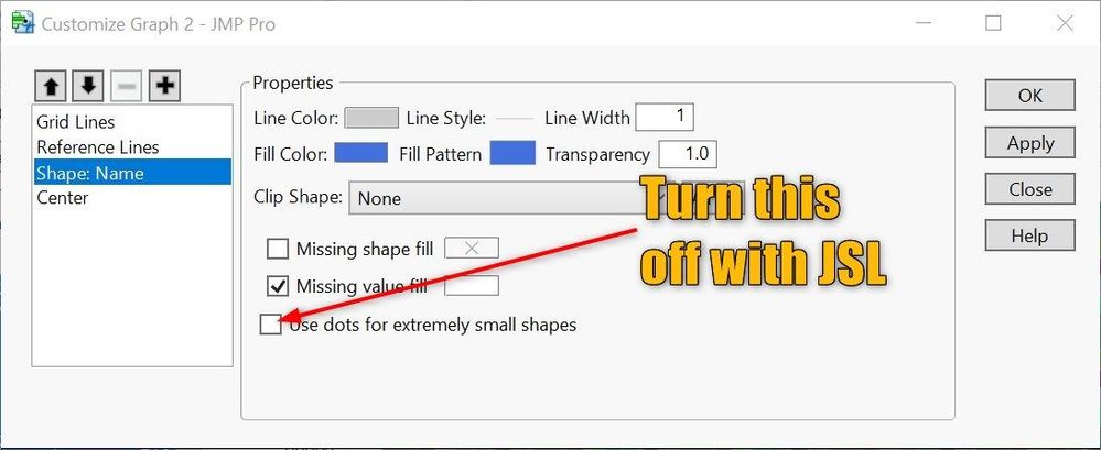

JMP17Pro --> How can I script the Shape:Name "Use dots for extremely small shapes" -- I want to turn it off
    //missing_shape_color
// THIS one works. target_graphics_script = target_window[Framebox( 2 )] << find seg( Shape Seg( 1 )); target_graphics_script << {Missing value fill( 2 )};
This is how I'm setting "missing value fill"  which seems to be an adjacent setting
What do I need to send to get rid of this dots thing.
Thanks!
I found a single reference to this "feature"
Tip: Very small shapes on a map can be made visible with a dot. To access this option, right-click on a map > Customize > Shape: X and choose Use dots for extremely small shapes.
https://www.jmp.com/support/help/en/17.0/index.shtml#page/jmp/scale-map-shapes.shtml
I tried all these permutations to uncheck this checkbox or turn it off but none of them worked.
	owFB = Report( gb_right )[Framebox( 1 )];
	owFB << DispatchSeg(Shape Seg( 1 ), {Use dots for extremely small shapes(Empty())});
	owFB << DispatchSeg(Shape Seg( 1 ), {Use dots for extremely small shapes("False")});
	owFB << DispatchSeg(Shape Seg( 1 ), {Use dots for extremely small shapes(0)});
	target_graphics_script << {Use dots for extremely small shapes(0)};
	target_graphics_script << {Use dots for extremely small shapes(Empty())};

Thanks for the reply, here's what I see.
I'm not sure which one of these needs to be interacted with to get that box unchecked.
I also don't see "missing value fill" here which is what worked for the other checkbox, the only reason I found it was saving the graph builder window as script and looking at what it had. It makes no mention of these use dots for small shapes thing though.
