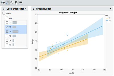

I have successfully made an interactive html report when doing the File -> SaveAs method, however, I'm having issues getting the interactive html to show the data filters when saving in jsl code. Can someone take a look and see if I'm missing something obvious here?

You might have to wrap it to new window first or take higher level reference to capture also filter

With higher (or rather highest in this case) level reference

Thanks Jarmo! I also found this previous post which captures your idea. It works now!
