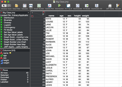

Is anyone having issues with Dark Mode? I have a Macbook and JMP15. There is a bug with dark mode and having gridlines on graphs, it knocks out the readability of the data tables.
Even when this is on blue text which you can't change is too hard to read on black background so I want to turn it off completely. I can't see how to turn off dark mode within JMP - does anyone know where it is? Currently have to turn dark mode off from Mac OS which turns off everything.

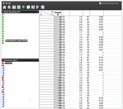

Re: JMP15 Mac OS Dark Mode
For instance, how do I get rid of the beige border on this fig? I could do it in jmp14 but not 15. This is an image I exported from journal. Adjusting the color scheme in preferences to make the border white, renders the text invisible in graph builder. Thanks for any assistance!
