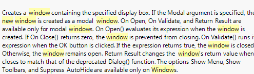

According to the scripting index if the << On Close() returns zero (0) the window is prevented from closing.
Screen Shot 2018-04-04 at 10.36.15 AM.png<<On Close
