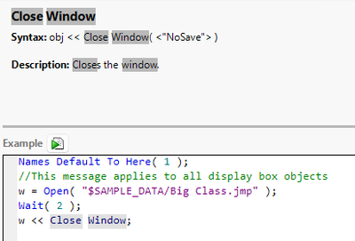

I think that you need to change the highlighted line to: "rbiv << Close Window;" And also move it down to where you no longer need it, e.g. where the arrow points to.
"rbiv << Close Window;" means that you want to close the report window.
It surprised me that "biv << Close Window;" works, too. But I won't recommend it, at least because the behavior is undocumented.

Thank you. Both solutions/recommendations helped but for different reasons.
Yes, the error appears to have been my incorrect use of the command biv << Close and not biv << Close Window. The Close command did not generate an error or appear to anything (hence my issue). This can be one of the frustrating issues with JSL. Commands or arguments that are not correct or appropriate in many cases do not generate errors and just quietly do nothing.  This makes it difficult to troubleshoot if the issue is the script itself or an incorrect use of a command.
Once I changed to the correct Close command, the incorrect location in the script became obvious since it generated an error since I still needed the it to grab the Parameter Estimates.
Really appreciate, the help....
