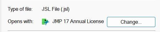

Right click on the .jsl and look at properties, it seems like this is the right file association?
Unless there is a new "script editor" or something I'm supposed to open these in?

There are quite a few posts in community regarding this here and there. If I remember correctly the option which has worked most of the time is to reset the file associations. What I have done since this started to happen to me (3-4 years ago...) is that I ALWAYS open all scripts holding ctrl as it prevents autorun.
