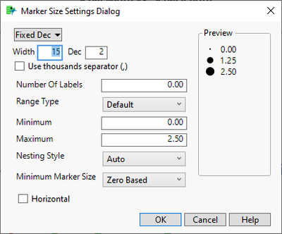

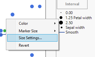

If you right click on the size in the legend a dialog opens where the min and max can be specified.  These appear to stay put when the local data filter is modified.

This option does not seem to be available in the older version of JMP (14.1): I'll need to upgrade.
Thanks.

You're right, I just checked and in 15.2.1 the option was not there, so it looks like you would need 16.0.
