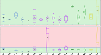

This is how it should looked after some manual work:

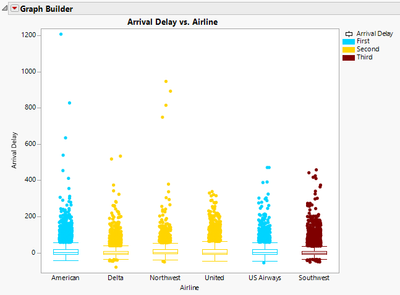

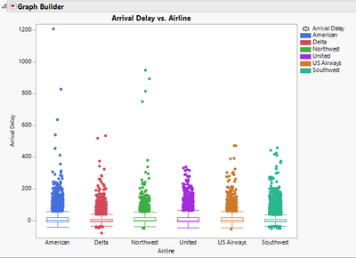

Boxplot with Airline in X-axis and Color:

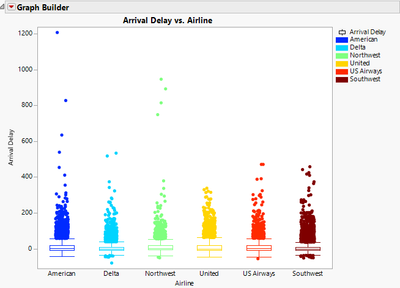

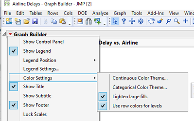

I can change the theme from Graph builder red triangle/Color Settings/Categorical Color Theme:
Or I could create a new Color column (Using my script found from this suggestion: Allow Name Selection In Column be used for multiple selections )

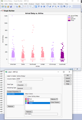

And then I can also use Column Properties in some cases to change the colors:
