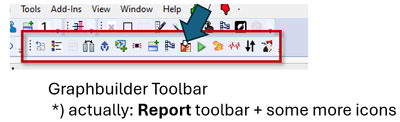

So, what you could do:
  • install Graph Builder Toolbar
  • use the local data filter to generate the individual steps
  • for every step, click on the Powepoint logo in the Graphbuilder Toolbar *)  and send the current plot as an image to Powerpoint
  • go to Powerpoint, select all images and add animations
