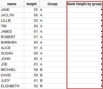

Hi there~ ^^
Could you do me a favor?
-1. I want to use "Rank by Group"
-.I use JMP ver 9.02
  I can use JMP function  "Col Rank(:height) "
  but I cannot use this by groupping   "Col Rank(:height, :Group )"   Cannot typing this ":Group
-2. How can I ranking   up-to-down  or  down-to-up(default)  by height?

As you have seen, there is currently no By option for Col Rank.  To accomplish the same thing, do the following:
1.  Add a column to store the original row order.  If you choose to use a formula with the Row() function, be sure to remove the formula after the values are stored in the column.
2.  Sort the table by height within Group.  You can choose to do this ascending or descending.
3.  Add a formula to the Rank Height by Group column that will assign a count which represents the rank within each group:
        If(Row() == 1, 1, If(:Group[Row()] == :Group[Row() - 1], :Rank Height by Group[Row() - 1] + 1, 1))
4.  Sort the table by the original row order column.
I hope this is helpful!

I was trying to solve this same problem and created a script that I could attach to my toolbar. Since there wasn't a single formula that can be easily applied, this script will manually assign the proper ranking to the current data table after it prompts the user for the relevant columns. Feel free to use or adapt if desired.
