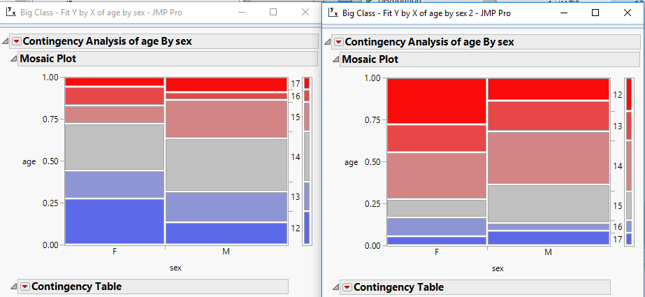

Hey Folks,
I was just wondering how to change the order of the data displayed in the mosaic charts. In the picture below, say I would like to change the order of the data to be displayed as blue at the top, or orange goes to the bottom.
Thanks in Advance,
Thomas
1 REPLY 1
txnelson
Re: How to change mosaic plot graph order?
All you need to do is to set the Column Property, "Value Ordering"  for the Y column to what ever order you want, and then run the platform.
The picture below shows the same Mosaic plot run before the Value Ordering was set for the column Age, and then again after the Value Ordering was set
Jim
