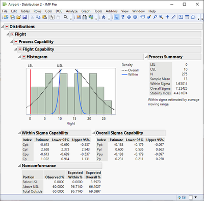

jthi
Re: JMP doesn't recognize my spec limits when column name is a variable in my user-defined function (JMP 17)
If you just need Process Capability for one column at the time I would use Distribution Platform in cases like this
Names Default To Here(1);
capability_chart = function({dt, colname, lowlimit, highlimit}, {Default Local},
	dist = dt << Distribution(
		Continuous Distribution(
			Column(:Flight),
			Quantiles(0),
			Summary Statistics(0),
			Histogram(0),
			Vertical(0),
			Outlier Box Plot(0),
			Process Capability(LSL(lowlimit), Target(.), USL(highlimit))
	return(dist);
dt = Open("$SAMPLE_DATA/Quality Control/Airport.jmp");
pc = capability_chart(dt, "Flight", 0, 10);
You will end up with a bit different report due to outline boxes, but those can be "hidden" if needed (or just take the Outline Box you are interested in to you report)
