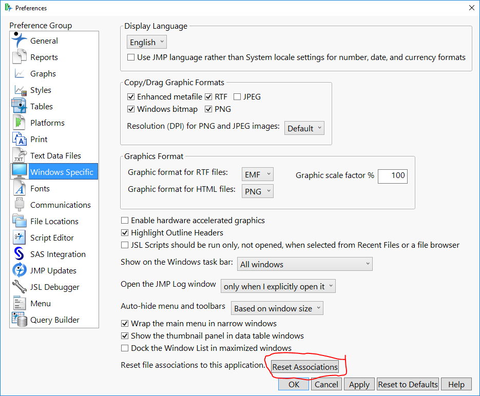

Resetting the file associations should reset that registry key.
File > Preferences > Windows Specific
Capture.PNGIf that does not work for some reason, you can create the registry key yourself in Regedit.
Please note that your jmpExists variable actually means "is JMP installed AND can JMP be automated."

Thank you, this worked!
