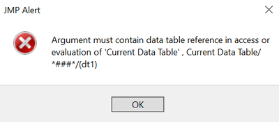

JMP alert: Argument must contain data table reference in access or evaluation of 'current data table', current data table/*###*/(dt1)
Hi,
I have encountered this problem when I run a old script on JMP 15. Anyone can help me to solve this problem? Thank you in advance!

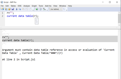

Thid error occurs when the argument to the function is blank.  The example below will throw that error:
r="";
current data table(r);
Jim
