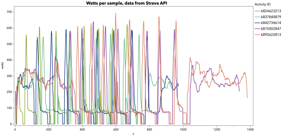

Fantastic @ngambles . This works great and thanks for posting the link to the video as well, which describes how to get the access token. These data are coming in as I'd like to see them. And plus this is a nice improvement over manually exporting them and combining them to a .csv file. Really sets the stage for automating this data pull and getting the data cleaned up to be analyzed and published on a regular basis to JMP Live. And yes, the watts are coming in for me through the API from your script.

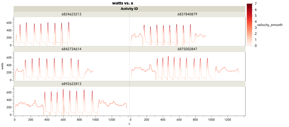

I pasted in @brady_brady 's formulas from above, and it still doesn't get all the intervals. However, thanks to  @ngambles 's Strava API code, we have another interesting feature in the data set to explore and use, which is the smoothed velocity column. I think this can be useful. You also now have the unique activity IDs to work with as another feature (knowing that I will only run between 6-10 sprints in any given activity. I think we should throw the ML model at it again, @Byron_JMP , now that we have a bigger training data set and a couple additional features to build the model.
I've attached the updated training data set.
And @Jordan_Hiller I think you should try too! You are a data cleanup pro.

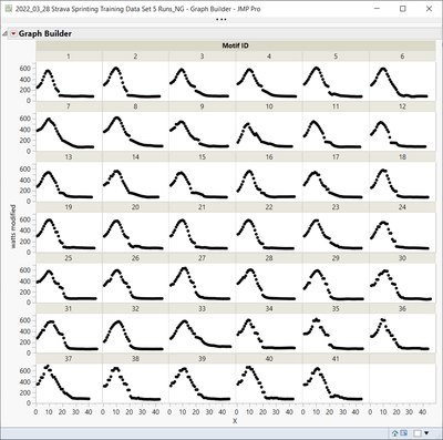

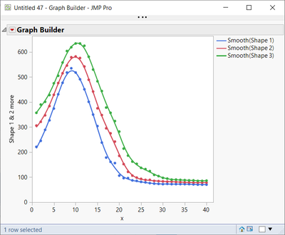

I have been thinking about my initial approach to this challenge and thought I could do it better so I have made a second attempt.
This time, I have defined several target shapes and then search through the data looking for regions where the shapes match reasonably well. My defined target shapes are:
This method requires fewer tuning parameters, and allows for more flexibility by allowing additional target shapes to be added easily.
I have added a column (watts modified) that performs a linear extrapolation when the watts value drops out during a run.
I have also added a column (Row State Formula) that automatically hides and excludes data points that are not associated with a motif ID.
In my opinion, this is an improvement over my initial solution to the challenge.
This method identifies 41 runs from the "2022_03_28 Strava Sprinting Training Data Set 5 Runs.jmp" data set
