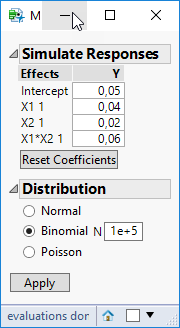

Hello!
I want to simulate responses using built in JMP Simulate Responses feature.
I use binomial distribution and my model for simplisity lets say is
p = 0,05 + 0.04*X1 + 0,02*X2.
(Actually I want to use simulation for fractional factorial designs.)
So
X1X2Y
-1-1 0.05
-11 0.02
1-1 0.04
11 0.06
In order to simulate this model what values do I need to enter in a Simulate Responses dialog box? Do I need to enter betas? But how do I derive them from coefficients?
Do I need to modify the formula?

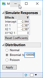

So now I understand that beta is calculated as folows:
Intercept (when all levels at -1 is 5% success rate)
is
ln(0,05/1-0,05) = -2,944
X1 (at -1 change from 0.05 to 0.09 at +1)  which is 80% uplift
This is the same as saying that it is an uplift of 40% versus the average response for both levels of the factor.
Which means p = 0.05-40% versus p = 0.05+40%.
p = 0.03 versus 0.07
Which means log odds for X1 = ln( 0.07 / 1-0.07) = -2,587
For X2 (at -1 change from 0.05 to 0.07 at +1)  which is 40% uplift
p = (0.05-20%)=0.04 versus (0.05+20%)=0.06
Which means log odds for X1 = ln( 0.07 / 1-0.07) = -2,752
So I enter this values to Response Simulator
03.28.2018-17.50
When I analyze the simulated data in Generalized Linear Model
I get different prediction responses from that I was expected
Could you please point me on my mistakes?
I have attached the project file if needed.

I think the problem might be that the intercept is not where all Xs are at -1. Rather, I think the intercept is where all Xs are at 0.
I haven't checked this but you might want to take a look and see if that makes sense.
Phil
cwillden
Super User (Alumni)
Re: JMP Simulate Responses feature for binomial data
Hi @gustavjung,
JMP parameterizes linear models a bit differently than what most people are used to.  The intercept is the average response (i.e. log-odds) across all factors, so as @Phil_Kay pointed out, it's actually when the values of X1 and X2 are 0.
If you want P( y = 1 | x1 = -1 & x2 = -1) = 0.05, then you need to basically need to input any combination of beta0, beta1, and beta2 such that beta0 + beta1*(-1) + beta2*(-1) = -2.944.  Obviously, there's infinite solutions, so just plug in whatever you want for 2 of the betas and solve for the last.
-- Cameron Willden

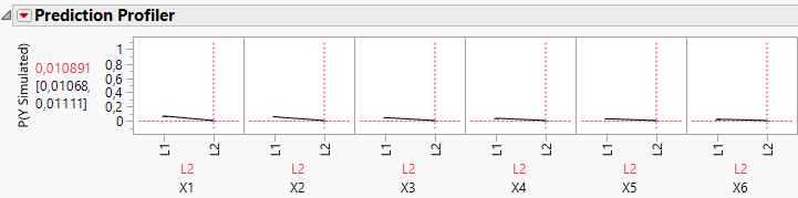

In Prediction Profiler
X6 at -1 is 0.010891
03.28.2018-21.11
X6 at +1 is 0.029
03.28.2018-21.13
How does it correspond to initial values?

While you might set the random seed for generating the design, that doesn't apply to simulating responses.  Therefore, you are going to get different results in your fitted model to the simulated data.  If you look at the parameter estimates, they should very roughly correspond to the coefficients you inputted into the simulation.
