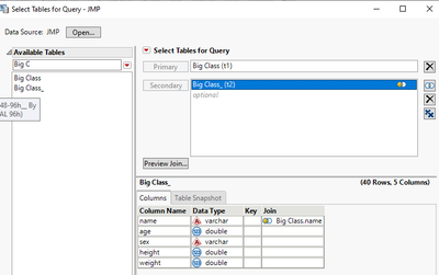

Hi,
Is there a way to specify a user defined suffix when adding columns to the "included Columns" in JMP Query builder?
The background:
I want to join several tables via JMP query builder.
All tables have the same content, but the values are from different measurements.
When I add the values of the second table, jmp detects that values with this name already exist in the list of "included columns" - and adds a " 2" for each of the column names.
For the next table, it adds a " 3" and so on - like it's the standard behaviour when columns with identical names are added to a table.
I would prefer to add user-defined suffixes like "_pre" for the first test and "_post" for the last test.
And perhaps "_intermediate" just in case that there is an intermediate test as well.
With the numbers, it gets confusing:
is " 2" the post-test - or is it the intermediate test, because there are also values with " 3"

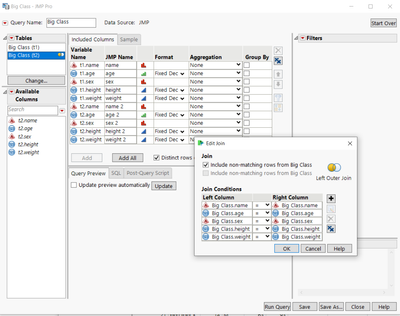

Is it really a join you need? When you join tables with same column names, JMP defines the join over all columns that have the same name here, I think this would not work for you, you have to edit the join and e.g. delete the conditions for height and weight.
Perhaps you can do it in a different way, you can concatenate the tables with name "Pre" and "Post", and save the table name in the result table. After that you can split the columns you need to be in the same row. I think, that way you have more control on what happens. A join over several (JMP) tables tends to get quite complex.

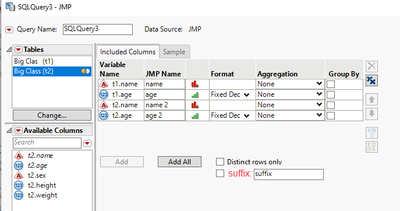

thanks, that's the nicest workaround up to now :)
Right, the desired merge pattern would look like the one below and not like the one that is suggested by jmp ;)
