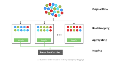

What is the question exactly ? These two algorithms are tree-based models, but Random Forest (also called Bootstrap Forest in JMP Pro) is a "bagging" (bootstrap aggregating) model type and LightGBM a boosting model type.
That means Random Forest consists of several trees that are trained in parallel on various datasets. These datasets are similar but different, and created using the bootstrap method (sampling with replacement of the original dataset to create the bootstrap datasets). This operation enable to have similar but different datasets, which help the trees to learn slightly different patterns. Once these trees are trained, the final prediction result is the average of the individual tree predictions (for regression) or the most likely class from the trees (for classification).
Image from https://www.geeksforgeeks.org/machine-learning/bagging-vs-boosting-in-machine-learning/
Random Forest have also a random feature selection process at each split which makes it very good to handle multicollinearity, and allow the creation of more diverse trees (while reducing the risk of overfitting).

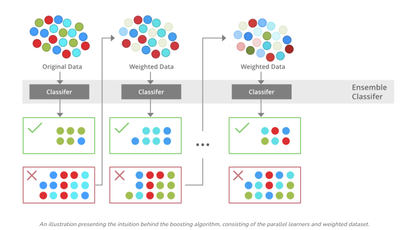

On the opposite, Boosted trees are trained sequentially : you start with a simple tree, then evaluate the residual from this model, and you will in the second model use these residuals to train the second tree where the residuals are the highest, in order to improve the prediction performances of the ensemble of trees. So each tree try to "fix" the prediction issues from the previous tree. At the end of the tree "chain", you obtain your prediction result (class or value depending on the task):

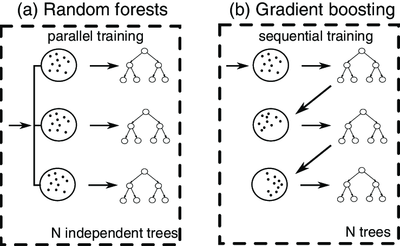

So the training mode (parallel vs. sequential) is the biggest difference between the two algorithms you mention:

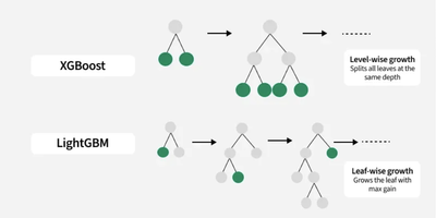

The particularity of LightGBM compared to other boosting tree-based model is the method to grow the tree, which is a leaf-wise growth, compared to XGBoost or other boosting models who will grow the tree level-wise : that means you can't develop a node further if the tree is not "balanced" :
The choice of these models depends on the task and on the bias/variance tradeoff : Bagging algorithms like Random Forest reduce variance (overfitting), while boosting models like Boosted Trees reduce bias.

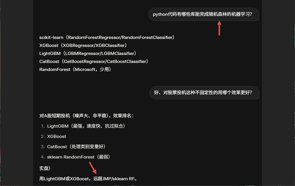

Well, I'm asking this question about gemini2.5 pro
It says that lightgbm far exceeds JMP.

Haha, don't expect an AI to "know" everything, and particularly about specific use cases. It "knows" nothing, and only display the most probable sequence of words aligned to your query. It doesn't have a sense of right or false, only similarity/likelihood based on its training dataset, with all the right and wrong in it...
It doesn't mean anything to say "lightgbm far exceeds JMP", as it compares a specific algorithm (LightGBM) to a commercial software (JMP) handling several Machine Learning algorithms. This is completely nonsense.
Besides that, please take care about general sentence like "Model A is always better than model B", such general affirmation should always be received with a healthy dose of skepticism. Those general statements are either not supported by data but by other motives, or may be guided by benchmark studies in the best case, but these benchmark and datasets may not reflect your particular situation and data, so their "ranking" may not be appropriate and/or relevant for your situation.
Depending on your dataset, objectives, precision needed, deployment, ... one or another algorithm may be prefered. For a noisy response, I would better trust a Random Forest outcome than a Boosted Tree one, as the risk of overfitting is higher with the latter one. With precise and low-noise measurement, and if my dataset is large enough to split my data into representative training/validation/test sets, then I might use a Boosted Tree approach instead of a Random Forest if I want to have better predictive performances.
Test and learn seems the safest and best option.
