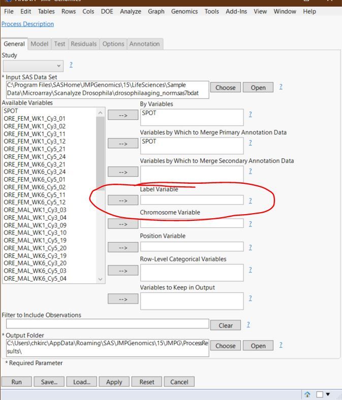

So, after more review of our sequence analysis software (Geneious Prime), we were able to recalculate expression at the gene level. This greatly reduced the amount of gene level redundancy, but there are still a few hundred rows in our input data tables with duplicate gene names, but unique accession numbers for these variants. I plan to use these unique accession numbers for the differential expression, but is there a way to carry over both the gene name and the accession number to annotate things like volcano plots, ANOVA output, etc? Thanks!
Re: JMP Genomics - Collapsing Isoform Level Differential Expression Data to Gene Level
Why yes there is.  By Variables adn Variables by Which to Merge Primary Annotation Data (if using a separate annotation file) items should be used with the accession number. You can use the Label Variable item to put the gene name into if it is in the same file as the expression data and the accession number. See screen shot as to where to put it.
