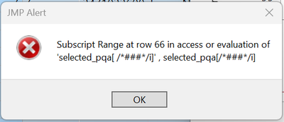

JMP Alert: Subscript Range at row 66 in access or evaluation of 'selected_pqa[/*###*/i]', selected_pqa[/*###*/i]
Hi JMP community,
I am having another issue with JMP scripting that is giving me the following error, even though I am getting the resulting output (charts and test results) I need:
Here is a partial JSL script that I think the problem lies:

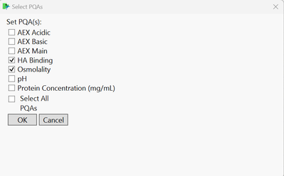

nw2 = New Window( "Select PQAs",
					<<Modal,
					Text Box("Set PQA(s):"),
					variablebox1_pqa = Check Box( unique_pqa ),
					H List Box(
						variablebox1_pqa_all = Check Box(
							<<SetFunction(
								function({this},
									variablebox1_pqa << Set All( this << Get, run script( 1 ) )
						Text Box(
							"Select All PQAs",
							<<Set Width( 90 ),
							<<Set Wrap( 90 )
					H List Box(
					//get all saved variable values when the user
					//selects the OK button from the menu
						Button Box( "OK",
							answers = Eval List({
							selected_pqa = variablebox1_pqa << get selected
						//	nw << close window;
						Button Box( "Cancel")
					//change popup window size
					<<Size Window(600,600)
// If cancel or red X was clicked, stop the script
If( nw2 == {Button( -1 )}, Stop() );
//Production of Output
//initialize a jmp report window
nw= New Window("JMP report results for each PQA",
    container = V List Box()
//loop through each PQA and paste results into the
//initialized jmp report window at each iteration.
for (i = 1, i <= N Items(unique_pqa), i++,
	content = V List Box(
		pqa_val = selected_pqa[i];
		dt << Select Where(:PQA == pqa_val);
		//subset the selected data, but make subset data table pop-up invisible
		listDT = dt << Subset(invisible,
			output table name( "Subset where PQA is " || pqa_val ),
			Selected rows only ( 1 ),
			Selected columns only( 1 )
This is the window where I can select PQAs, or all PQAs. I do not get the alert when I select all PQAs. I get the alert when I select a handful of PQAs.
Can you help me resolve this alert?
