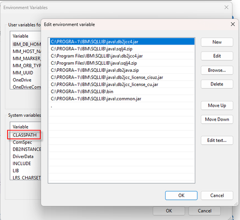

Classpath has been defined for JDBC driver.

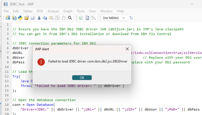

But still gives error that it failed to load Driver.
Appreciate, if someone can share working solution.
// Ensure you have the IBM Db2 JDBC driver JAR (db2jcc4.jar) in JMP's Java classpath
// You can get it from IBM's Db2 installation or download from IBM Fix Central
// JDBC connection parameters for IBM Db2
dbDriver  = "com.ibm.db2.jcc.DB2Driver";
dbURL     = "jdbc:db2://db2.exampleURL.com:50001/isdw:sslConnection=true;sslVersion=TLSv1.2;"; // Replace with your host, port, and DB name
dbUser    = "username";                         // Replace with your Db2 username
dbPass    = "mypassword";                      // Replace with your Db2 password
// Load the JDBC driver
Try(
    Java Open( dbDriver ),
    Throw( "Failed to load JDBC driver: " || dbDriver )
// Open the database connection
conn = Open Database(
    "Driver=JDBC:" || dbDriver || ";URL=" || dbURL || ";UID=" || dbUser || ";PWD=" || dbPass
// Check if connection succeeded
If( Is Empty( conn ),
    Throw( "Database connection failed." )
// SQL query example
sqlQuery = "select lot_id,
............ example SQL query that has been working in ODBC................ order by lot_Id, wafer_Id, parm_Label, level WITH UR ; "; // Execute query and load into JMP data table dt = Execute SQL( conn, sqlQuery ); // Close the connection Close Database( conn ); // Show the data table if results exist If( !Is Empty( dt ), dt << Show Window, Print( "No data returned from query." ) );

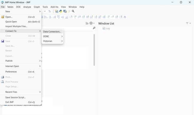

1) JMP Query Builder is going directly into Open Data File dialog box.
2) Alternatively tried File --> Connect To --> Data Connections
However, it only shows existing ODBC connections or lets create new ODBC connections only. No JDBC connection option.
