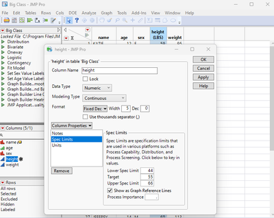

I ran your JSL without issue using JMP 18.1 on Windows 11.
Names Default To Here( 1 );
dt =
// Open Data Table: Big Class.jmp
// → Data Table( "Big Class" )
Open( "$SAMPLE_DATA/Big Class.jmp" );
LSL = 44;
target = 55;
USL = 66;
show_limit = 1;
Units = "LBS";
colList = dt << get column names(string,continuous);
i=1;
Eval(
	Eval Expr(
		dt:(collist[i]) << Set Property(
			"Spec Limits",
			{LSL( Expr( LSL ) ), USL( Expr( USL ) ), Target( Expr( TARGET ) ), Show Limits( Expr( Show_Limit ) )}
		) << Set Property( "Units", Expr( UNITS ) )
Are there any messages in the JMP Log?
Jim
