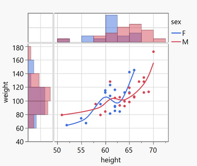

To customize each individual graph size, like here:
use
Relative Sizes( "X", [157 427] )
from Subplots with different sizes?
