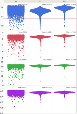

Hello all,

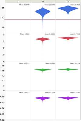

I'm having an issue where I want to display data points with "packed" jitter, but graph builder isn't displaying one subset of data in this way (see group "D" in the first image below).  The two other subsets (D2, D3) display packed jitter as desired.  All columns in my data table are numeric, continuous.  I'm not sure if this has to do with the number of points - subset "D" has 129k points, subset D2 has 13k, and subset D3 has 16k points.  Another acceptable way to display this data would be contours, but graph builder doesn't display subset "D" at all when selecting contours (2nd image below).  Hoping the community can offer some suggestions.  Thanks in advance!

yes, seems to be caused by the number of points. a bit lazy.
I experienced the same some while ago: Graph Builder - small and big subset
The issue with contours is surprising - back then switching to contours was the solution in my case.

I'm running into the same issue.
