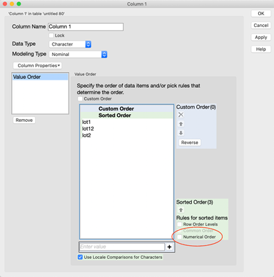

In JMP 14 and beyond you can turn off turn off the Numerical Order in the Value Order column property.
-Jeff

Starting with JMP 14 JMP began to recognize numeric suffixes on character strings should be sorted in numeric order instead of alphabetic order.
See more at Order the Levels of a Categorical Variable.
-Jeff

Thank you, that’s a lot of info on charts but how would I get it to sort the previous way in my script?

Re: JMP 14 column ordering difference
-Jeff
Perfect thanks will give that ago.
