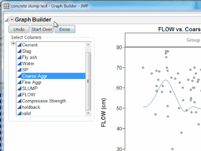

There's a menu/toolbar at the top of every report window. It's hidden by default but will appear when you hover your mouse just below the title bar or press the Alt key.
You can read more here.

The selection tool has not been removed.
If you go to your output window, and click on the "S" key, does the selection tool appear? And then if you click on the "A" key, does the arrow pointer come back?
What I assume you are experiencing is either that you are not aware of the "hidden" pulldown menu/toolbar screen, at the top of each JMP window, or the View==>Toolbars
not been selected.
Could you be a little more descriptive about your current setup, etc?

Thanks.  For clarification the selection tool is visible on the worksheet tool bar but greyed out/inoperative.
