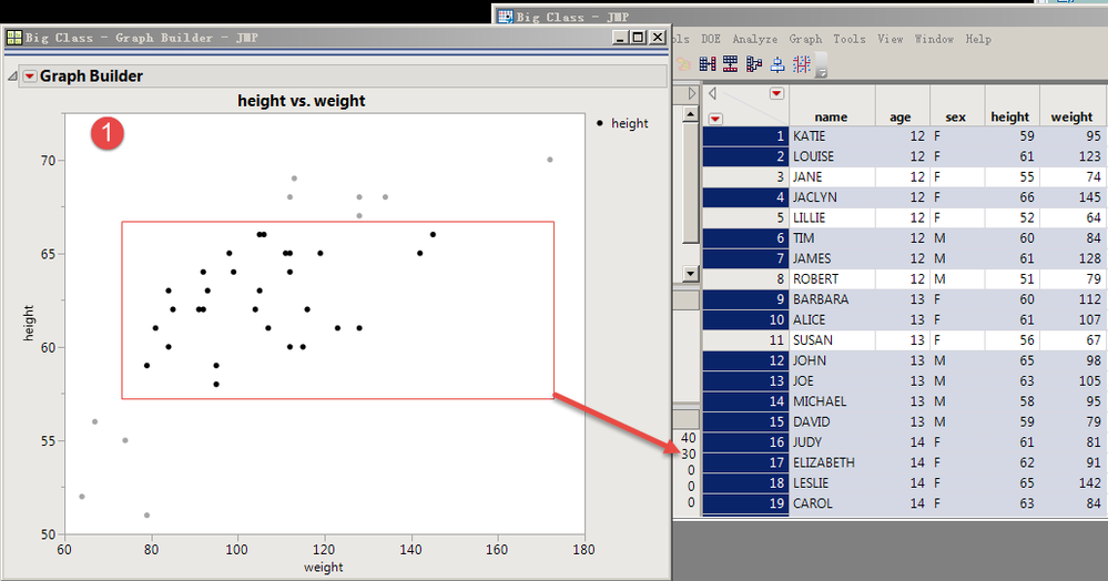

例如用Big Class.jmp的身高、体重作散点图。选定部分数据、如图1

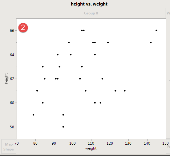

JMP能否自动将这个选定30行数据、重新作图生成图2:

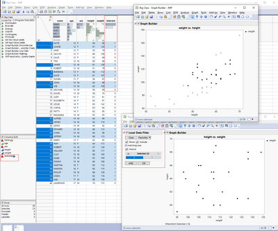

I'm not sure if JMP can do that by itself, but you can help JMP with Formula Column which will update row values if the row is selected (make  that column Nominal):
Selected(Row State())
Then use that column as a Local data filter in the new graph builder (you can also minimize the Local data filter):
I suggest checking out this video by @brady_brady: Special Formula Columns . It will show this trick and other useful tricks with some formula columns.
