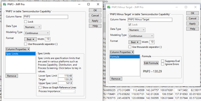

and you end up with columns like this (target won't be updated IF you change the column property)
