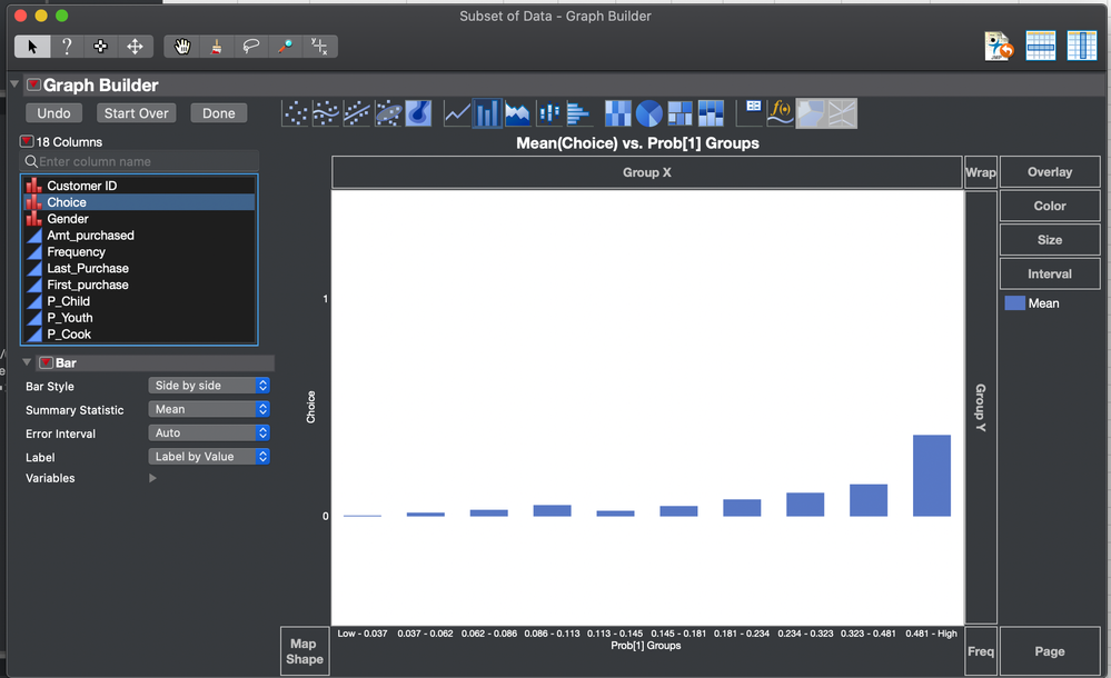

Hi,
I'm working with a logistic machine learning model and I would like to display the probability cutpoints on graph builder. However, I cannot display these values, even when selecting the "Label By Value" under Label. This is a picture of my output:
Screen Shot 2021-05-03 at 11.31.23 AM.pngScreen Shot 2021-05-03 at 11.31.23 AM.png
Please let me know if you know how to fix this issue, thanks!
1 REPLY 1
Re: Issues with "Label By Value" in Graph Builder
Instead of doing a bar chart, change the graph type to a mosaic plot since you are plotting two categorical variables against each other. From here you can turn on labels and get the percentages for each group.
