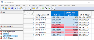

I'm on the tail end of a script where I've summarized a bunch of data in various columns (both numeric and character).
Looping to format numeric cells meeting certain criteria is easy enough but I'm having some issue assigning a color for character columns that contain a certain substring.
For instance, a cell (with the following content:1,1,2,1,1,2,3,3) should be colored red because it contains at 1 occurrence of the character '3'.
If I specify the entire content of the cell, no problem but I try to look for '3' and color accordingly ->fails.

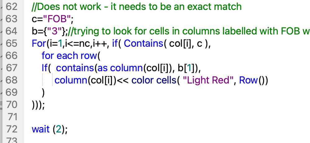

Change your code to match line 67 in the code below.
Contains ( ) lets you do a couple of different things, depending on the arguments you supply. For example:
Contains ( {"cat", "dog", "mouse", "dog", "horse"}, "dog" ) returns 2, because the first occurrence of "dog" in supplied list is at position 2.
Contains ( {"cattle", "dog", "mouse"}, "cat") returns 0, as "cat" does not occur in the list. If we want to search the list element by element to see whether "cat" is a substring of any element, we have to iterate through the list.
Your original code is a bit like this last example: Contains (b, :col) checks whether the column cell value matches any element in b, which you've defined as {"3"}. No match is found.
Conversely, the new code, Contains(:col, b[1]), checks whether b[1], the first element of list b, which is "3", is contained in the column cell value. Used this way, the Contains (<<whole>>, <<part>>) function looks for substring <<part>> within string <<whole>>--which is what I believe you want.
