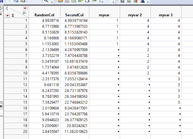

However for some reason every time I change the value of the “simulator” variable, a new column is created as of the second iteration in the “result” table with the same name of the variable and filling it in with the value in a strange pattern (see picture)
Basically it adds the value of the variable at the previous iteration in the active columns for the new concatenated rows and the value of the final iteration to all the other rows…

Those get added there due to the table variable. You could for example drop the table variable from your subset table after creation and then after each concatenate

If you concatenate two tables with different values for the variables a new column is added to "track the value it had in the original tables"
i can see why one wants to do that but is a strange behavior that is confusing
