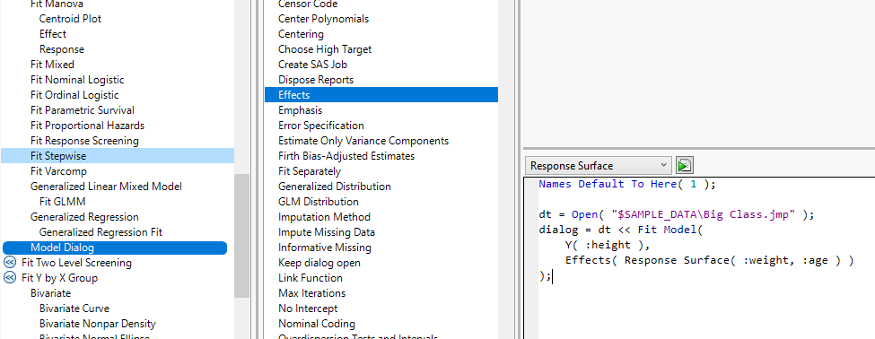

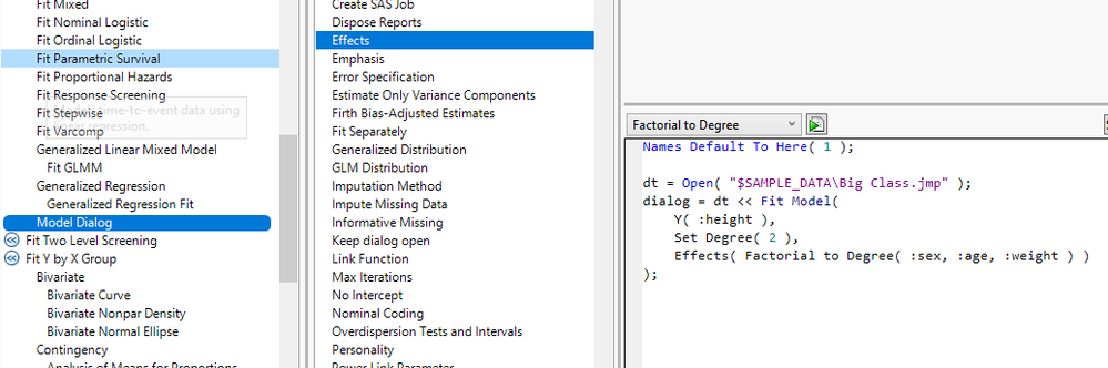

  • Response Surface()
  • FactorialtoDegree()
Learning every day!
peng_liu
Level VII
Re: Is there an easy way to script the Fit Model Macros?
These? They are in 17.
