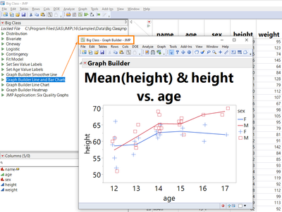

Hi, I often find myself saving a few scripts that used the same application (e.g. Graph builder) to a datatable. When you run these scripts the window title of the graph will automatically be "Datatable - graph builder".
When multiple scripts are run this creates the situation of having windows open with titles "Graph Builder 2", "Graph Builder 3" and I lose track of which script generated which window.

Example: script opens a window with generic "Graph builder" title.

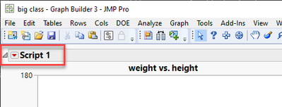

What if instead of changing the window title you just changed the name of the outline box in that window?  You can do that by double clicking on the name, and that is maintained in the saved script.
