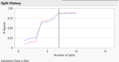

I just tried the Partition platform and I think the outcomes could be what you're looking for.
I used it on your data with a 20% validation set (specified in the launch dialog window) in order to know when to stop splitting data (when training and validation results remain stable) and avoid creating too many splits in the data:

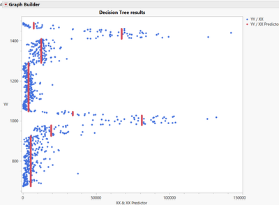

When displaying the results with the formula saved from the platform, it's easier to spot areas with similar values :

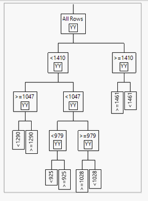

You can thanks to Graph Builder identify the ranges of similar values, or create a small script that creates groups based on predicted values in the datatable, and/or use the small tree view to identify the ranges in your data :

In addition, how is the red vertical line added in the following figure?
  • How can get its value?

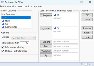

If you want to reproduce the analysis on other file, you can launch manually the platform with the corresponding settings :
  • Your response (here XX) in the "Y, Response" panel
  • Your factor(s) (here YY) in the "X, Factor" panel
  • Finally, you can set a validation portion (between 10 and 20%) in the corresponding panel (bottom left) :

The red vertical lines comes from the prediction formula of the Decision Tree and is directly linked to the inner working of tree-based methods. A Decision Tree will create splits in the factor(s) values based on a criteria to create more homogeneous subsets of data. For Regression Tree, this criteria is often MSE (Mean Squared Error), MAE (Mean Absolute Error) or SSE (Sum of Squared Error).
The value used for splitting is determined by testing every value for every factor, so that the one which minimizes the sum of squares error (SSE) best is chosen. So by splitting your data into "chunks" where you calculate for each of this part the mean value, you minimize the difference between predicted values and actual values, and actually reduce SSE. This explains the "stairway" step profile look of the prediction formula.
On the table, you can get the prediction values of this formula in the column "XX Predictor" saved, and in the platform , you can click on the red triangle next to "Partition", go into "Save Columns" and "Save Prediction Formula". As you can see, values are the same for each range/split done, and corresponds to the average of actual values in this split/group. This is quite helpful in your use case, as you can directly identify groups of similar values (corresponding to the same predicted value with the Decision Tree).

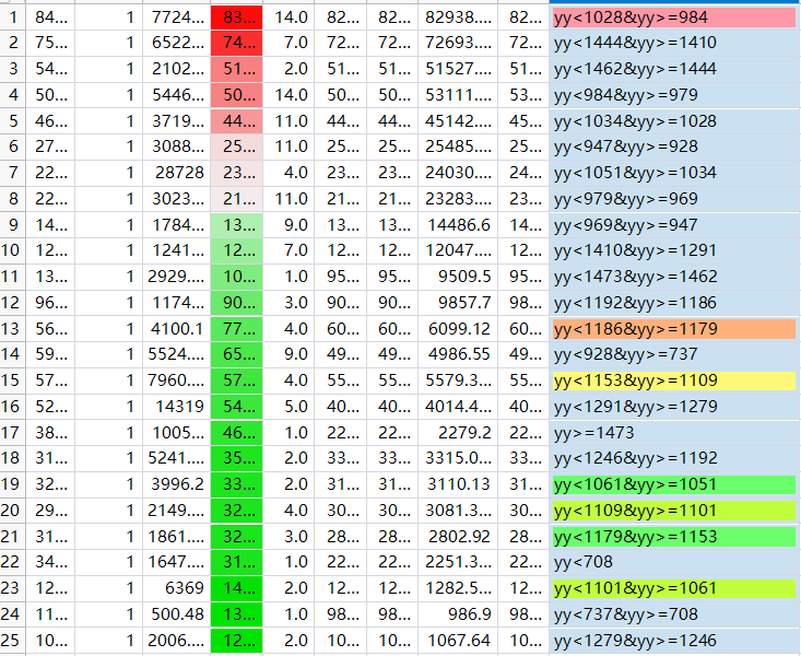

This Partition module is heavily used, but with low-level duplication and no further functionality to use it.
I run JMP using scripts.
It automatically splits if you add go.
p = Partition(
	Y( Column( 3 ) ),
	X( Eval( xF ) ),
	Method( "Decision Tree" ),
	Validation Portion( 0.2 ),
	Informative Missing( 1 ),
	Column Contributions( 1 )
p << go;
