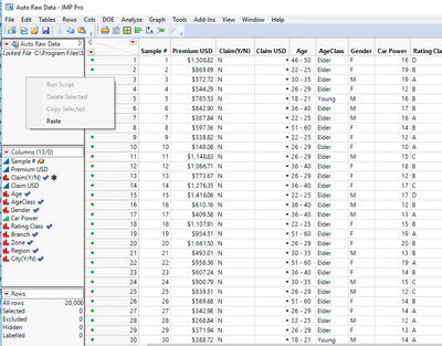

2. Go back to the parent table and right-click in the upper-left corner and select "Paste":
3. The "Source" script for the subset is now a Table script in the parent table. You can always rename it as you like.
