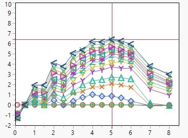

Is there a way to automatically draw ref lines at the peak of curve in a plot?
How do I darw a line at the peak of the curve without manually seraching for the peak?

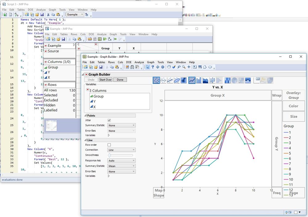

You can determine the peak by finding the Max value for each group, then find the X value by finding the row that the Max value is found.
Here is an example of the output and the simple script that creates the reference lines.
and here is the script

// Create the graph
gb = Graph Builder(
	Variables( X( :X ), Y( :Y ), Overlay( :Group ) ),
	Elements( Points( X, Y, Legend( 9 ) ), Line( X, Y, Legend( 11 ) ) )
// Find the number of groups and their max
Summarize( dt, bygroup = by( :group ), theYMax = Max( :Y ) );
// Loop across the groups and create reference lines for the max Y found in each group
For( i = 1, i <= N Items( bygroup ), i++,
	theXMax = dt:X[(dt << get rows where( :group == Num( bygroup[i] ) & :Y == theMax[i] ))[1]];
	Eval(
		Substitute(
				Expr(
					Report( gb )[AxisBox( 1 )] << add ref line( __x__ );
					Report( gb )[AxisBox( 2 )] << add ref line( __y__ );
			Expr( __x__ ), theXMax,
			Expr( __y__ ), theYMax[i]

Craige_Hales
Re: Is there is way to automatically draw ref lines at the peak of my curve in a plot?
Check the log window, the message suggests this needs a tweak:
theXMax = dt:X[(dt << get rows where( :group == Num( bygroup[i] ) & :Y == theYMax[i] ))[1]];
