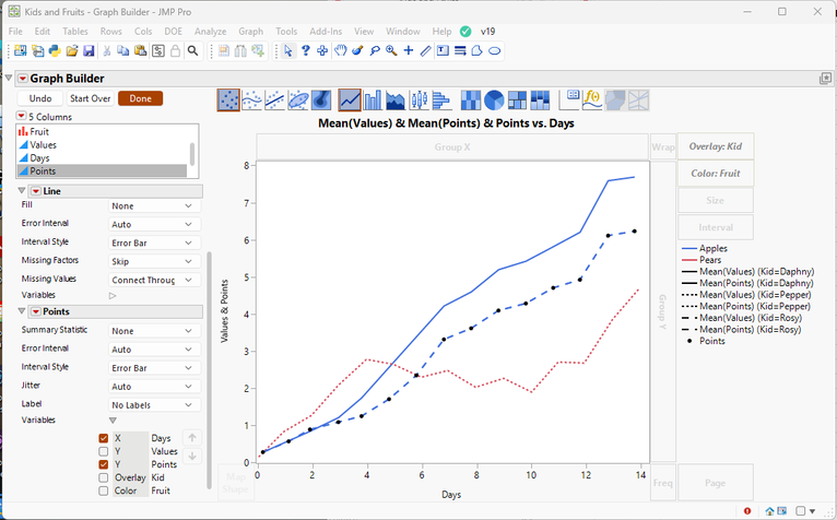

Add a new column and place only a copy of Rosy values into the new column.  Then add this new column to the y axis.  Then in the variables section, uncheck everything except Days and the new column.  In my example I called the new column Points.

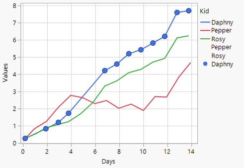

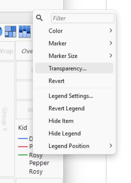

If you don't want to change the data table, you can add points (for all 3 lines) and use the legend/right click to reduce the transparency for 2 of them:
Graph Builder(
	Variables( X( :Days ), Y( :Values ), Overlay( :Kid ) ),
	Elements( Line( X, Y, Legend( 1 ) ), Points( X, Y, Legend( 2 ) ) ),
	SendToReport(
		Dispatch( {}, "400", ScaleBox,
			{Legend Model(
				2,
				Properties( 1, {Transparency( 0 )}, Item ID( "Pepper", 1 ) ),
				Properties( 2, {Transparency( 0 )}, Item ID( "Rosy", 1 ) )

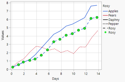

For a more advanced analysis (e.g. if there are dozens of entries and you don't want to reduce the transparency X times), you can:
  1. use a transform column to calculate 1/0 for data with & without marker  (here: fruit = "Pears")
  2. use this transform column as "color"
  3. then you just have to adjust 2 settings instead of dozens of  entries
Graph Builder(
	Transform Column( "Rosy", Nominal, Formula( If( :Kid == "Rosy", "Rosy" ) ) ),
	Variables(
		X( :Days ),
		Y( :Values ),
		Overlay( :Kid ),
		Color( :Fruit ),
		Color( :Rosy )
	Elements(
		Line( X, Y, Color( 1 ), Color( 1 ), Legend( 1 ) ),
		Points( X, Y, Overlay( 0 ), Color( 2 ), Legend( 2 ) )
	SendToReport(
			{Legend Model(
				2,
				Properties( 0, {Transparency( 0 )}, Item ID( "Missing", 1 ) )
If there is a conflict for overlay or color, you can disable or enable them separately for specific graphs:
